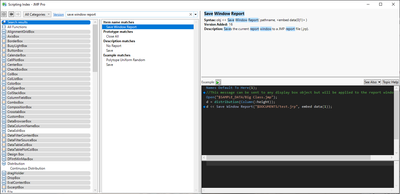

According to Scripting Index << Save Window Report is used to save the report as JMP report file
I think you have to use Save Picture if you wish to have SVG and if you are using By variables, you might have to wrap your report to new window (or get a reference to the report)

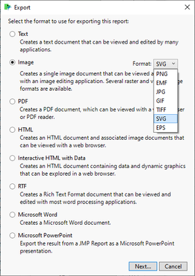

And why use save picture is based on this Export option and a guess
