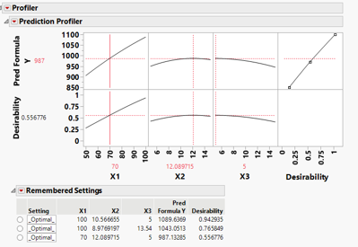

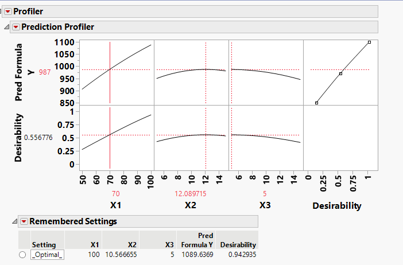

In JMP 17.2.0 I am using Optimization and Desirability -> Maximize and Remember to generate optimized settings for different situations (e.g. factors locked differently). When saving the Profiler as script to Data Table and re-open, only the first setting is there and the others are gone. Would it help if I changed something in the preferences?

Hi @andresm,
I think changing the names of your different optimas may help.
If I saved different settings in the Profiler without changing the names of these optimas, then the script doesn't contain the others optimas saved :

I think the default name for a remembered setting is "_Optimal_" and works ok if you only save one, but if you save several ones, you need to change the naming in order to avoid names conflict.

I attach my example file here. Also screenshots of Profile before saving as script to data table and after running the saved script.
I also attach the saved script.
Andres
