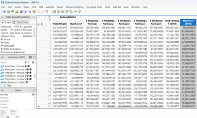

As you can imagine, there are no easy ways to do this by only using clicks (the process is quite tedious to repeat), so I would recommend try scripting it (but I am clearly not a scripter). As an example, I tested it on the Diabetes dataset with an RBF SVM with cost=0,265 and gamma=0,09 and only repeating the process 4 times (so 5 resample formulas, file attached) :
Once my mean and StdError columns have been created from these 5 resample formulas, I can use the Profiler with these two columns :
