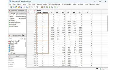

  • If Hard to change factors can't vary independently from Very hard to change factors, then the levels of Hard to change factors are nested within the levels of Very Hard to change factors (Split-Split Plot designs, 2 subplots per whole plots here) :Split-split plot design.jpg

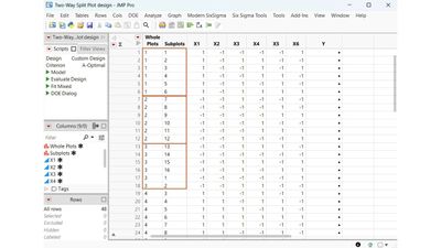

  • If Hard to change factors can vary independently from Very hard to change factors (option checked), then the levels of Hard to change factors are randomized within the levels of Very Hard to change factors (Two-Way Split Plot designs, 6 subplots per whole plot here) :Two-way split plot design.jpg

Here the script for the Split-Split Plot design with 48 runs, 8 whole plots, 16 subplots situation with no independant variation between very hard and hard to change factors:
DOE(
	Custom Design,
	{Add Response( Maximize, "Y", ., ., . ),
	Add Factor( Continuous, -1, 1, "X1", 2 ),
	Add Factor( Continuous, -1, 1, "X2", 2 ),
	Add Factor( Continuous, -1, 1, "X3", 1 ),
	Add Factor( Continuous, -1, 1, "X4", 1 ),
	Add Factor( Continuous, -1, 1, "X5", 1 ),
	Add Factor( Continuous, -1, 1, "X6", 1 ), Set Random Seed( 1232803225 ),
	Number of Starts( 312 ), Add Term( {1, 0} ), Add Term( {1, 1} ),
	Add Term( {2, 1} ), Add Term( {3, 1} ), Add Term( {4, 1} ), Add Term( {5, 1} ),
	Add Term( {6, 1} ), Add Term( {1, 1}, {2, 1} ), Add Term( {1, 1}, {3, 1} ),
	Add Term( {1, 1}, {4, 1} ), Add Term( {1, 1}, {5, 1} ),
	Add Term( {1, 1}, {6, 1} ), Add Term( {2, 1}, {3, 1} ),
	Add Term( {2, 1}, {4, 1} ), Add Term( {2, 1}, {5, 1} ),
	Add Term( {2, 1}, {6, 1} ), Add Term( {3, 1}, {4, 1} ),
	Add Term( {3, 1}, {5, 1} ), Add Term( {3, 1}, {6, 1} ),
	Add Term( {4, 1}, {5, 1} ), Add Term( {4, 1}, {6, 1} ),
	Add Term( {5, 1}, {6, 1} ), Set N Whole Plots( 8 ), Set N Subplots( 16 ),
	Set Sample Size( 48 ), Optimality Criterion( "Make A-Optimal Design" ),
	"A-Optimality Parameter Weights"n(
		[1 1 1 1 1 1 1 1 1 1 1 1 1 1 1 1 1 1 1 1 1 1]
	), Simulate Responses( 0 ), Save X Matrix( 0 ), Make Design}
And here the script for the Two-Way Split Plot design (also called "Strip plot" and visible in the script) with 48 runs, 8 whole plots, 16 subplots situation with independant variation between very hard and hard to change factors:
DOE(
	Custom Design,
	Add Factor( Continuous, -1, 1, "X6", 1 ), Set Random Seed( 868486588 ),
	Number of Starts( 341 ), Add Term( {1, 0} ), Add Term( {1, 1} ),
	Add Term( {5, 1}, {6, 1} ), Make Strip Plot Design, Set N Whole Plots( 8 ),
	Set N Subplots( 16 ), Set Sample Size( 48 ),
	), Simulate Responses( 0 ), Save X Matrix( 0 ), Make Design,
	Set Run Order( Keep the Same ), Make Table}

  • The whole plots structure is adapted, as you need for your configuration up to 6 degree of freedoms to estimate the intercept (1 DF), the 2 main effects (3 DFs because one of the main effect is linked to the three-levels categorical factor, so 2 DFs are needed), and the interaction between the two very hard to change factors (2 DFs because of the three-levels categorical factor).
    In total you need 6 DFs, so with 8 whole plots the situation is OK. I just checked by lowering the number of whole plots to 6, and I see two error messages in this situation: one for the whole plot (because not enough DFs to estimate whole plot variance), and one for the subplots (in the case when the very hard and hard to change factors cannot vary independently).
  • In the subplots structure, you need 16 DFs if you're using a RS model without some terms removed like you mentioned (and if my calculations are correct): 2 DFs for the main effects of hard to change factors, 6 DFs for the interactions between hard to change and very hard to change factors, 2 DFs with the easy to change factors, and 2 DFs for the quadratic effects of the hard to change factors. You then have to add 2 DFs for the main effects and 2 DFs for the quadratic effects of easy to change factors, so total = 16 DFs required.
    • If the very hard to change and hard to change factors can't vary independently, you'll have only 16 individual and independant "group" of observations (2 different subplots per whole plot), so that leaves no DFs to estimate subplot variance.
    • If they can vary independantly, you'll see that the design structure allocates the subplots randomly to the whole plots, which greatly increases the DFs to 48 (since there are no combinations  of whole plots x subplots "repeated" like in the "dependance" scenario), which is large enough to estimate the required model terms and subplots variance.
