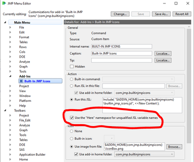

That said, to disable the Names Default to Here( 1 ) in the addin version, uncheck the following box:
