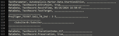

Just to contribute to this topic further, the most likely issue when I use such scripts is the Job id format consistency. Pay close attention on how to construct the job ID and don't change it arbitrarily, which would distort the programming if not followed. To give two examples, my job id standard format is: Projname_Lot id_wafer id_personal note: index X index Y
But, since this is a bench test and I manually named all the tests, there were some cases where I myself violated the rule and did NOT EXACTLY follow the style above:
1. missed the "_" between lot id and wafer id, say, instead of "753367.1_W11", I typed "753367.1W11" in some cases;
2. added two personal notes instead of one: e.g. when do retest after the 1st run,  instead of using "_2nd_", I used"_1st_redo_". Since I use "_" as info section divider, it would cause trouble there plus anything following that section as the counting messes up.

jthi
Re: Rookie question on data table generation (extraction) from raw probe data
Depending on your application, you might be able to make the parser more robust by looking for repeating patterns instead of relying on regex patterns matching specific lines. For example it looks like your project name for example is between MetaData lines
Depending on the assumptions you can make, you could extract it based on those MetaData and "empty" lines instead of relying on "line starts with Proj" or "line matches this regex pattern".

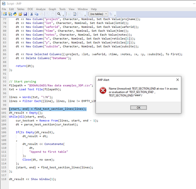

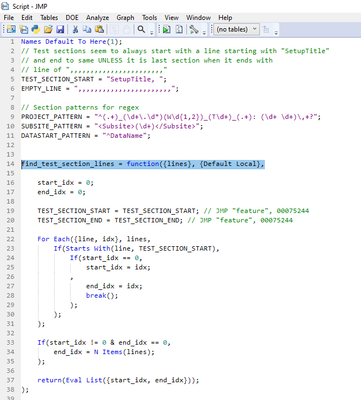

Hi Jthi,
Somehow I am getting this error while running this script. Can you please guide?
jthi
Have you defined TEST_SECTION_END?
-Jarmo
Yes, I am using the same script you posted earlier.
jthi
Ah.. they have been dropped for whatever reason in my script and you will have to determine TEST_SECTION_END. Quicky looking it might be the same as EMPTY_LINE.
