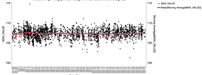

I have 180 days of recent data totaling 2574 rows in JMP. I have included a file with just two columns, one is the DATETIME stamp and the other is the MAX_VALUE data at that timestamp.
I have created an X-Y chart of MAX_VALUE (Y-Axis) vs DATETIME (X-Axis).
I wish to add a trendline where its value at any given time is equal to the average value of MAX_VALUE over the past 30 days.
Can somebody help me fit a line for the 30day moving average of this dataset?
thanks.

Unfortunately, this only averages the previous 30 values of MAX_VALUE. My data is not in discrete increments, for example, the previous 30 days for one output should have about 350 inputs, whereas the Col Moving average suggestion you have given me would have just 30 inputs (the previous 30 datapoints). Can the input for ARG 2 (Weighting),  ARG 3 (Before), ARG 4 (After) etc be manipulated to use DATETIME as an input such that it applies to every other row where DATETIME is less than or equal to the current rows DATETIME value?

This is actually correct, I had arrived at this same dataset by using the following function:
Col Moving Average( :MAX_VALUE, 1, :DATETIME <= 30 * 86400, 0 )
But this function increments by seconds for 1 month (Over 2.5 million iterations) and JMP struggles for a minute before outputting the result.
The way you have done it is much less memory demanding, Thanks!
