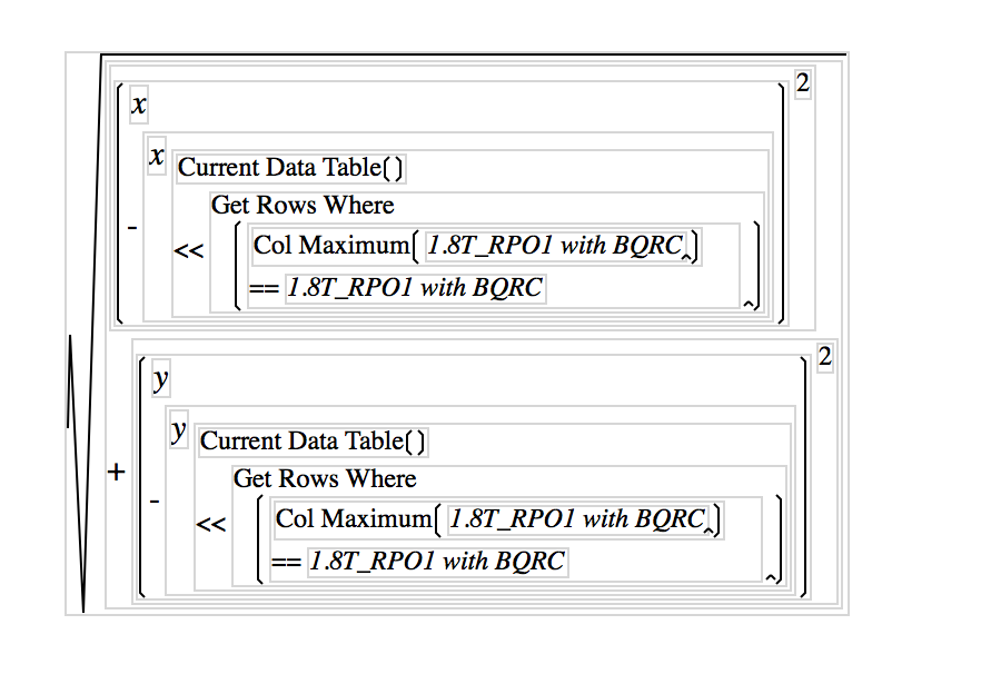

Hegedus
Level IV
Re: Return the Row Number of Maximum
Thank you!
Slightly tweaked but this is what I have and it seems to work.
