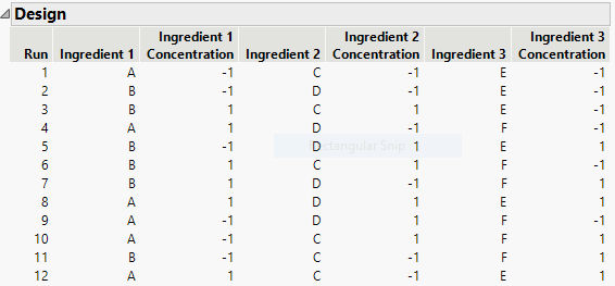

Here is a design based on my approach, so we have something tangible to discuss.

Are you saying that either A or B is present at some concentration, but not simultaneously? Then you might have one two-level categorical factor to identify the ingredient (e.g., levels A and B) and another factor for the non-zero concentration range.

Ah yes now I understand your approach!
Would it also work to make each ingredient 3-level categorical, including A, B or 0? Or do you foresee problems with such an approach?
Re: Restrict combinations in DOE
I think your scheme works if you have several pairs of ingredients and some formulations should not include either of the two options for a given pair.
