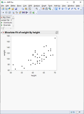

Is there a way to fix/resize by user the size of the data box?
Currently the size of the box is set automatically due to the objects in the window.
New Window("A",
	H List Box(
		V List Box(dt << New Data Box(), obj = dt << Bivariate(Y(:Weight), X(:Height))),
		Spacer Box(<<size(30, 0))

However, I have a full-screen dashboard with a data box inside, meaning the main window is fixed in size (full-screen). I would like to adjust the size of the data box independently of the parent window.

Resizing scroll box does not resize the data box.

the minimum height is given by the side panel, so maybe close it?
- and reduce the size of the header:
db << close side panels( 1 ) << close summary panels( 1 ) << Set Header Height( 20 );

Thanks! Was looking for "close side panels". Very helpful.
