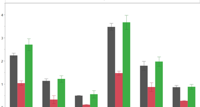

I have a question on both graphical and statistical representation. In the following bar chart, the interaction between the two treatments is significant, so the most ideal way to represent the results graphically would be a bar chart with the following aesthetics:

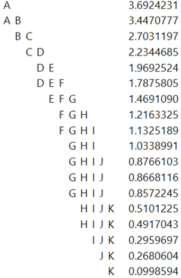

Performing the Tukey of the interaction, the result of the analysis is as follows:
Although this JMP output would be the most statistically correct, since you have all the information between treatments, is there a way in JMP pro to be able to statistically compare between main treatment and secondary treatments, simplifying the results graphically for the reader's understanding?

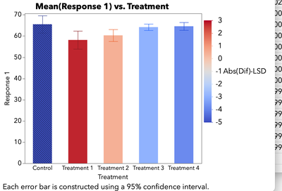

I don't know what the "right" answer is but I might try something like this:
 I used the fit y by x platform to do a means comparison using Dunnet's with control.
In this example the control is actually named "control" so the platform doesn't ask which level is the control. It the baseline treatment isn't named "control" then you'll be asked to specify which one is the control.
