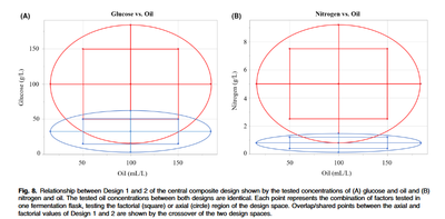

Setting the scene - use simple visualisations to show the structure of the DoE and how the points are being explored - you can do this with Graph Builder or the Scatterplot Matrix when you have loads of factors - this helps readers understand that the DoE is a structured approach to experimentation. Similarly, having a table where you show the coding of your factors (if you're using -,0,+ and axials (a,A) will really help.

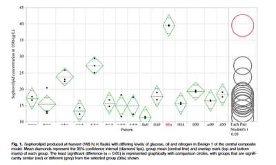

Showing what you achieved - before you jump into the regression model and the greater complexities of the DoE approach, you should highlight the real values that you've got, a simple plot in Fit Y by X using something like a Tukey's test is a really clear way to show 'Look how much more stuff I made' using the DoE approach - one of the great strengths of DoE is that it's a structured way of exploring an experimental region, the modelling approach after is another plus! In the example above you can see my '00a' is a lot more productive then the other points - in reality I could stop there because I've got what I wanted!

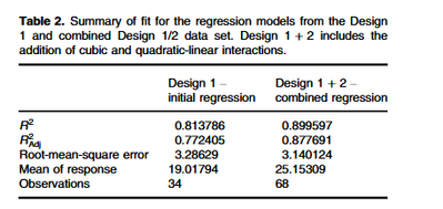

Introducing the model - as you've mentioned, you're showing the basic information required to prove that your model is sufficient - depending on your target journal, that should be more than enough to prove that you've built a good model and you might not need to dive deeper (unless you're targeting a very statsy journal). If you have material like your studentised residuals and actual by predicted plot - make sure to include them, but maybe in your supplementary information.

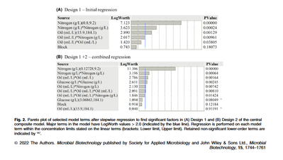

Introducing the modelling concept - The Pareto Plot is a great way for a reader to look and really quickly pull apart the significance of your terms and also a great way to introduce more complex concepts like quadratic curvature (X1*X1) and interactions (X1*X2) - the reader can quickly see that 'Blue Line is good' and understand where terms have less importance - this is a great point to link this into your understanding of the system, for example, Nitrogen is highly important to production because of the reliance of the organism used in this paper on it for growth. This helps to show that you're not just running a statistical experimentation method, but that you're using it to understand your system better.

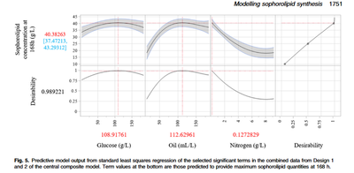

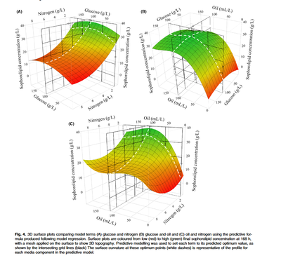

Combine the many ways to show your surface - Personally, I love the Prediction profiler and it can be a great way to show off your system and how it operates, but as you mentioned it can be stunted when you have to present it statically - if you have a simple system, you can show different shots of the prediction profiler with different settings. In my case, I showed the prediction profiler at the optimum (which showed the shape of my factors) and combined it with the Contour Plots to give more understanding to my system. As a tip - if you set your Contour Plot to the same factor settings as is in your Prediction Profiler, the area where the tall grid 'intersects' with the surface (which I added a white highlight to) reflects the surface on the Prediction Profiler!

For the first one I used a graph builder to plot the points, then I used PowerPoint to draw the shape of the squares and circles in the same colour.
For the second one, you can use Fit Y by X where the X is your 'Pattern' and Y is your response - then I did a means comparison with a Tukeys test to display the comparison circles.

About the Prediction Profiler, you could maybe provide an interactive HTML file or embbed the Profiler on a web page (website, or JMP Live) if you want to share it.

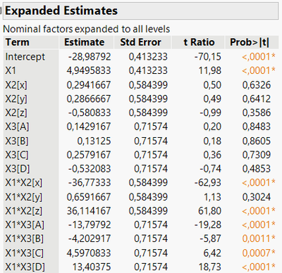

If one (or several) of your factors is categorical/ordinal, you can provide the interaction effect value for each categorical level by displaying the Expanded Estimates of your model :
Hope this clarify my point,
