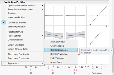

  • If you want to reorder the factors and responses in the Prediction Profiler, you can click on the red triangle next to Prediction profiler, then "Appearance", and then "Reorder X variables" or "Reorder Y variables" :

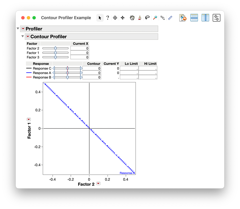

Thanks for the quick reply, Victor! Hopefully the below screenshot clarifies my question.
I'd like Factors to be in a more logical order "Factor 1, Factor 2, Factor 3" going down the list. I'd also like Responses ordered by "Response A, Response B, Response C" going down the list as well.
Is it possible and/or scriptable in the Contour Profiler platform?Screenshot 2024-02-14 at 11.34.11 AM.png

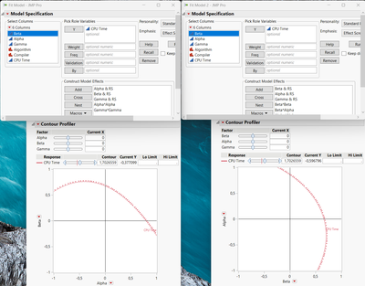

If you're using the "Fit Model" platform to have the Contour Profiler, the order in which you see the factors and responses is directly linked to the order in which the factors and responses are introduced in the "Fit Model" panel :
In the Contour Profiler platform when you use directly saved Prediction Formula in your table, the order of factors in which you have created your formula (with Fit Model platform for example) will stay the same.
If you have several responses when using the Contour Profiler platform, the first Prediction formula introduced will dictate the order of the factors and will be displayed first in the response panel :
You can reorganize your datatable to group factors and responses and reorder them when building your models, so that the order you would like to have is kept in the Contour Profiler platform.
In your concrete example, create your models with ordering of the factors 1, 2 and then 3. If you save the prediction formulas of responses A, B, C, open the Contour Profiler and keep the same order of the prediction formulas A, B, C, you should get the correct ordering of factors and responses.
