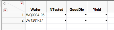

Hello,
I would like to calculate row data by referencing columns/data found in another table.  I am trying to calculate Yield in Table #2 by pulling data from Table #1 without joining the tables. Is there a way to do this? Here is what I have so far...
Table #1 = WaferRgDt
Table #2 = dt1 : I am trying to populate this with data that is calculated from Table #1
For( j = 1, j <= N Rows( dtWaferIDList ), j++,
	Eval(
		Parse(
			tempj = Column( dtWaferIDList, 1 )[j];
			dt1 << select where( :Wafer == tempj);
			dt1 << Add Rows({Wafer = tempj
			, NTested = If( Selected( Row State( Row() ) ), Col Number( :Name("FailDie")))
			, GoodDie = If( Selected( Row State( Row() ) ), Col Number( If(:Name("FailDie") == 0, 1, . )))
			, Yield = If( Selected( Row State( Row() ) ), 100 * :Name("GoodDie") / :Name("NTested"))})
The main logical issue with this code I am having is that the column "FailDie" is not a part of table dt1, but instead a part of Table #2 and I don't think it is able to read that data in its current state.
