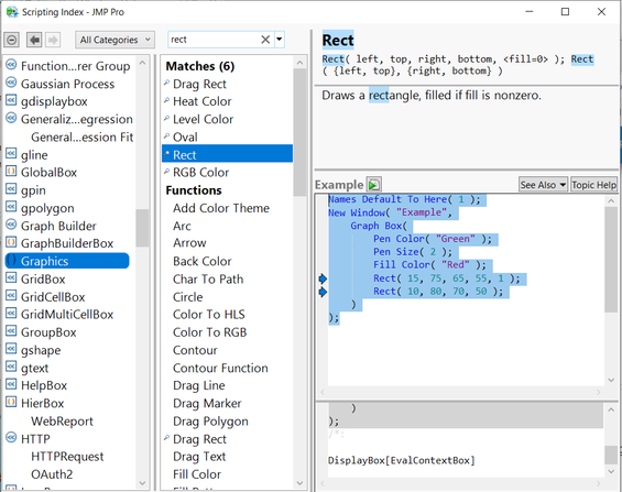

JMP has a complete set of graphic primitives' that can be used for creating things such as rectangles.  The Scripting Index details the functions available and gives examples of their use.
Here is the script from the Rect() function description.
Names Default To Here( 1 );
New Window( "Example",
	Graph Box(
		Pen Color( "Green" );
		Pen Size( 2 );
		Fill Color( "Red" );
		Rect( 15, 75, 65, 55, 1 );
		Rect( 10, 80, 70, 50 );

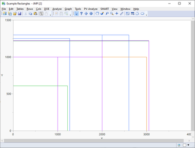

Lots of overlap in your data.  This code will do it; I set the rectangles to unfilled to show the overlap.
dt = data table("Rectangles");
// Set some constants
xmin = 0;
xmax = 4000;
ymin = 0;
ymax = 1500;
xres = 800;
yres = 500;
color_list  = {"Red", "Blue", "Green", "Orange", "Purple"};
filled_rect = 0;	// set to 1 for filled rectangles
heat_map_win = New Window( "Example Rectangles ",
	rect_gb = Graph Box(
		framesize( xres, yres ),
		xscale(xmin, xmax),
		yscale(ymin, ymax),
		for (i = 1, i <= nrows(dt), i++,
			xleft   = dt:x 1[i];
			xright  = dt:x 3[i];
			ybottom = dt:y 1[i];
			ytop    = dt:y 4[i];
			pcolor  = color_list[dt:material[i]];
			pen color(pcolor);
			fill color(pcolor);
			rect(xleft, ytop, xright, ybottom, filled_rect);

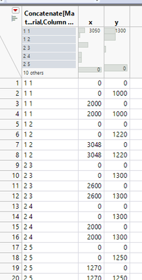

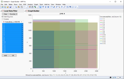

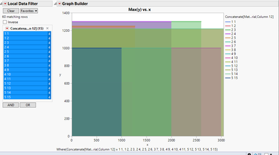

I would definitely do this with Graph box but you can try to do something with Graph builder also. If I understood the data correctly you have couple of different versions per material. Based  on that I did some split/stack/formulas to get table like this:

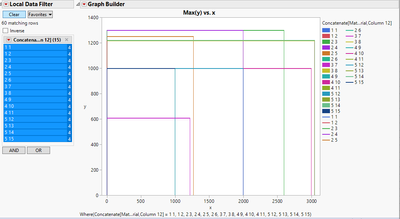

With this table I then created Graph builder and used smoother with confidence of fit ON.

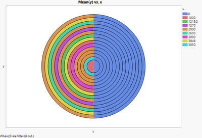

These two happened by accident and will work only because all rectangles have "line" in x = 0:
Bar chart + line char:
Also using line with fill below:
Datatable attached with tablescript.
Bonus image from same data:
-Jarmo

jthi
Re: Rectangle Graphic
 What sort of data do you have? You can for example create custom shape files
-Jarmo

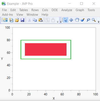

	Graph Box(
		Pen Size( 2 );
Jim
xmin = 0;
xmax = 4000;
ymin = 0;
ymax = 1500;
xres = 800;
yres = 500;
		xscale(xmin, xmax),
		yscale(ymin, ymax),
			xleft   = dt:x 1[i];
			xright  = dt:x 3[i];
			ytop    = dt:y 4[i];
			pen color(pcolor);
			fill color(pcolor);

jthi
-Jarmo
