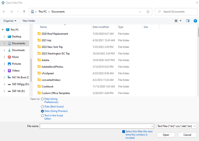

     File=>Open
and navigate to the folder where the file you want to input resides.
Click on the down arrow in the box currently displayed as "All JMP Files ........" and select
A new area in the window will be displayed that will allow you to used different approaches to open the files., Click on
     Data (Using Preview)

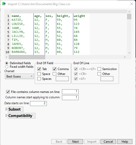

The Preview Window will open
There are different settings you can change on this window, but considering that you specified that you want to use Tabs in addition to Commas, Click on the Delimited fields check box and then check the Tab check box.
A preview of what the different fields will be are displayed in the window.  If it is what you want, then click on Next, and when the next window appears, click on Import.
Your data table will appear.

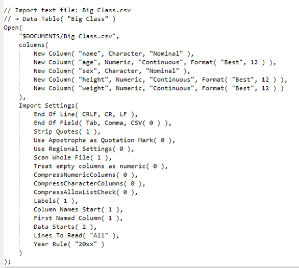

Now to get a copy of the JSL  you can just open the Log window and it will list out the JSL that it used to open the data table.
The JSL is pretty straight forward.  If you cut and paste this JSL into your script, you can then just change the pointer to the file you want to open, and the Import Settings will handle the End of Field options you changed.
