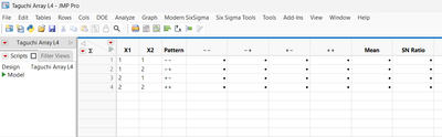

I have read in several papers showing the limitations of Taguchi designs that Taguchi did create design in a practical and "engineer"-focused way, to the detriment of "statistical correcteness". JMP provide the same format as you mentions when creating Taguchi designs, with noise factors considered as "repeats" and using the response average and standard deviation to calculate a S/N ratio (example with L4):
Without considering the inner and outer arrays cross as a split-plot experiment, I'm afraid that running the analysis in the same order as the table is provided would cause a potential bias in the experimentation, because of the possible influence of external (and not considered) noise factors. Also Covering array platform has the same challenge with the ordering of the runs, but it could be possible to consider it as a split-plot experiment, so thanks for this good advice.
