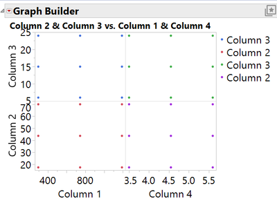

Good day! Me and my group mates are currently doing our thesis and we have been instructed by our adviser to make use of JMP for RSM and CCD. We don't really understand how to go by it. We have 4 variables and we would like to test their effect on three other variables. If we just do CCD with 4 continuous factors then we would only have 26 runs and we're confused because it will only fit 26 of the results when we need 29. We're sorry for the ignorance, this is our first time making use of JMP. We're using JMP Student Edition and attached is the sets of data we would like to treat with columns 1 - 4 being the factors and 5 - 7 being the affected variables. Again, we apologize for any wrong terms, it really is our first time making use of this software and treating data like this. Thank you for all the responses!

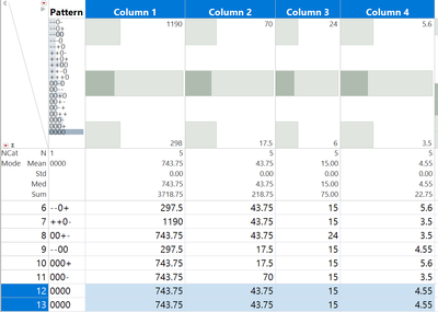

Looking at your results, you are trying to recreate a face centred CCD design
Having a look at the data, I changed the columns into a 'Pattern' (this makes them easier to read), as you can see, the number of replicates seems to be randomly arranged in pattern.

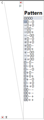

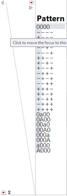

I've tried to reproduce this in JMP with a face centered CCD
And a Box-Benkhen design
And I can't get them to match what you've put in your original table, as you can see these designs will simply add more centrepoints, if you add replicates, it will add them for each pattern.

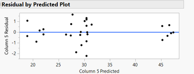

  • When fitting Response Surface regression model to your response columns, a strange pattern appears in tthe predicted vs. actual and residuals :
    It seems you have a strong difference between response values depending on the factor 1 that leads to the creation of 3 groups of points. Did you realise the experiments in the order of the table or did you arrange the order of the experiments by the value of factor 1 ?
    I wonder if this groups situation is linked to a possible re-ordering of the experiments, or if the ranges difference between factors may explain why experiments can be grouped by factor 1 values. I would recommend trying to validate your model for factor 1 levels between min and middle levels, and/or between middle and max levels, to be sure the trend is consistent over your experimental space.
