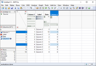

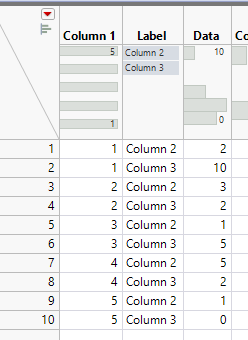

Stack the data columns (column 2 and column 3):
Add new formula column to check if row is max for specific Label
:Data == Col Max(:Data, :Label)
From here you have 1 on those rows which are maximum for labels
-Jarmo
-Jarmo
Re: Pulling Row Data for each Max Value from a Column
Yup, that's what I was looking for. I like the Stacked idea. I was just playing with using a Formula to add the flags, but I think the Stacked column would make that cleaner!
