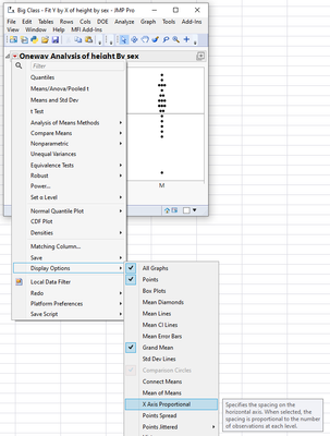

Re: Proportional X-Axis Display Option?
At least in some cases it is available

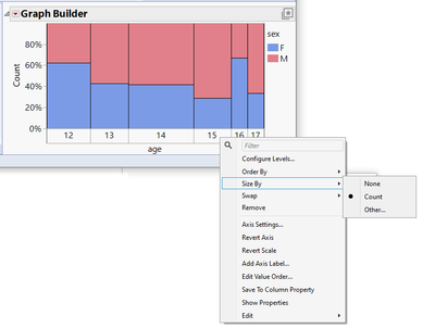

In Graph Builder - besides Mosaic Plot -  proportional scaling is disabled by default.
To enable it, use Size by count:

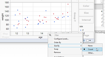

Mosaic Plot has a size by count setting as well - but surprisingly without effect:

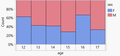

To generate a Mosaic plot without a proportial x axis scaling, just use the bar chart, with the grouping column as Overlay
(Mosaic:  y axis)

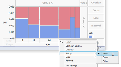

And if you want to generate a "mosaic-like" graph (with proportional axis scaling)  graph, just enable Size by - Count
