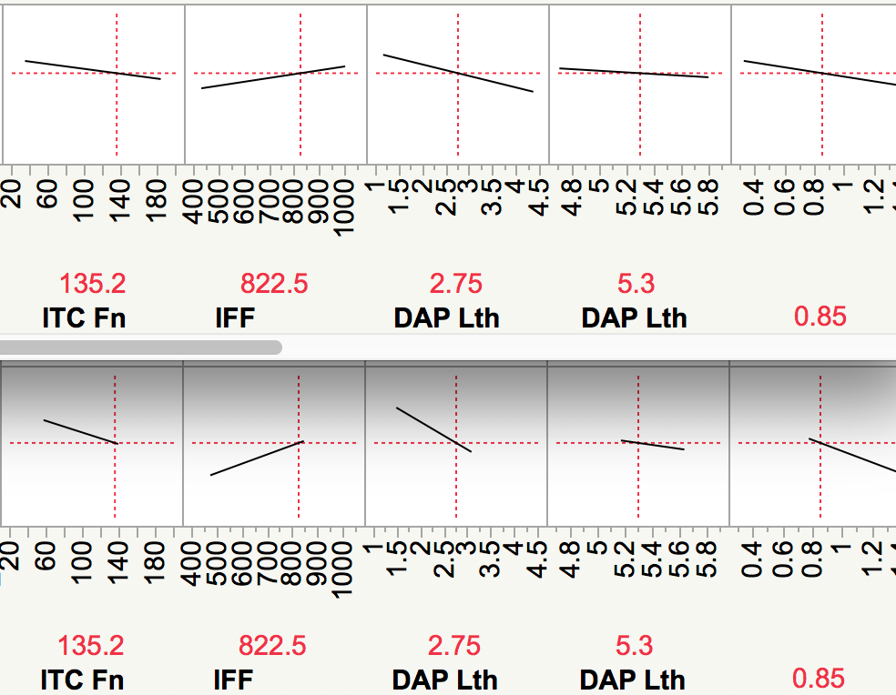

I am getting different behavior in situations where I have constraints on many X's with some of these constraints acting on one Y and other constraints acting on another Y, leading to situations like this (top profiler is on Y2 only, second profiler is the Y2 row from a profiler on both Y1 and Y2). Notice that if I don't save both Y1 and Y2's prediction equations and profile them (bottom profiler), the constraints are not respected on Y2 alone.
