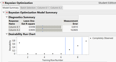

Hi Victor in your succeful 6 run initial abov I only see 2 outputs Column 6.1 and Column 6.2 see below. There i a 3rd one Y, I don't see it
Incuding Y I can't detect the right optimal settings also not with 10 run see attachment (I recoded the 3 outputs as Y1, Y2 and Y3)
What did I do wrong? It is important for us to understand.
With 9 intial runs it always works perfect, why?
