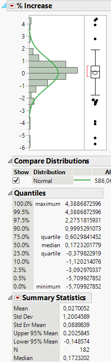

Hello,
I have the following distribution with a mean of 0,027.
Based on this distribution, is there a way to find out what is the probability of a number to be more than or equal to 0,000269? Is there also a way to simulate how many times in a row can the number be less than 0,000269?

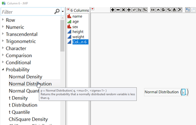

Thank you for your answer, but I am not sure where to find the normal distribution function.
mlo1
Level IV
Re: Probability
If you open the Formula editor in the Column header you find different options:

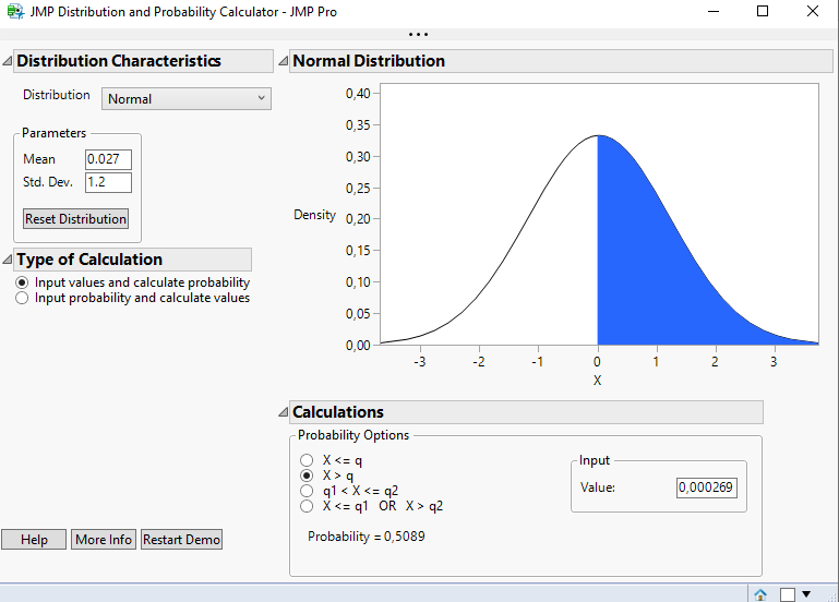

I found this probability calculator and entered the mean and standard deviation of my distribution. Then I entered the value I want to observe and it gives a 50,89% probability of a number greater than that of occurring. Is that correct?

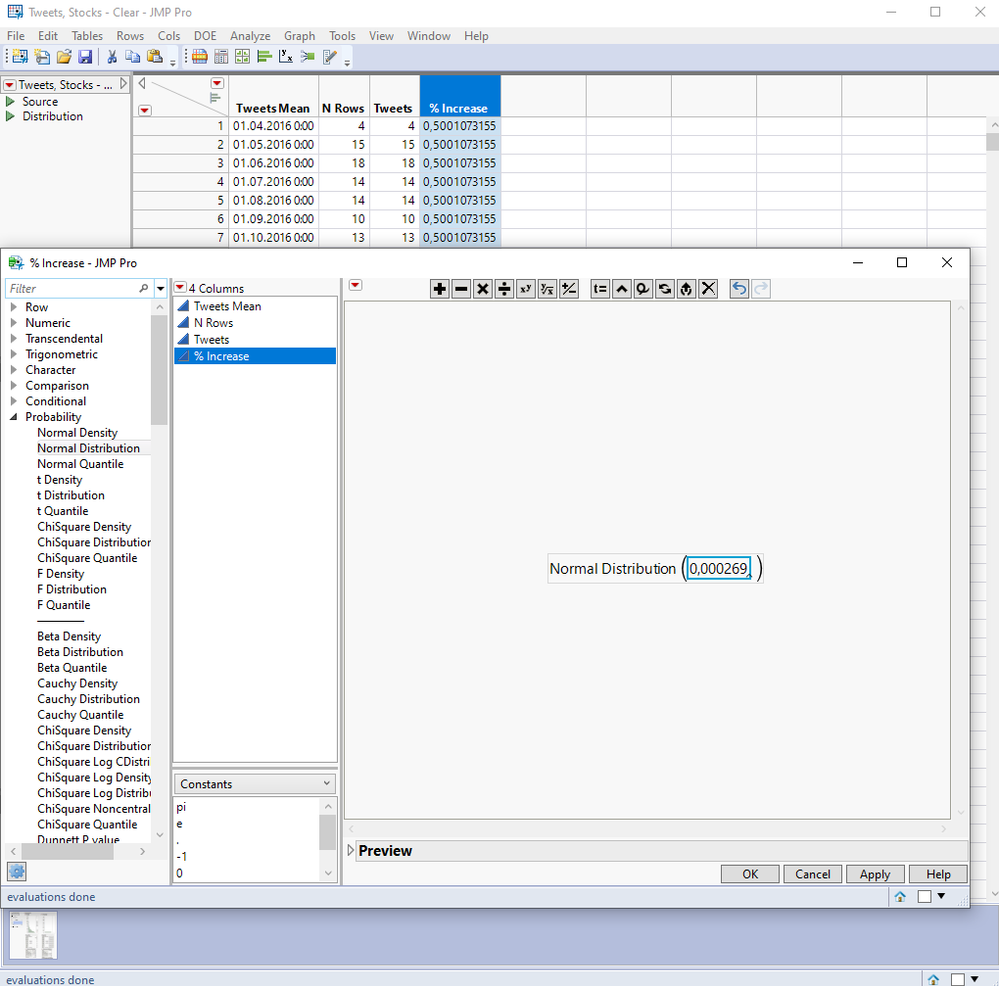

However, something does not seem right to me (I think I am not doing it right).
Does that mean that there is a 50,01% probability of a number less than 0,00269 to occur?

Re: Probability
names default to here(1);
prob = normal distribution(0.000269, 0.0270052, 1.2004589);
double_row_prob = Prob * Prob;
This gives you the probabilty of a value beeing less than 0.000269 if the distribution is normal with the mentioned parameters.
The probability needs to be less than 50% because the value is less than the mean. In your screenshot you looked at the wrong side of the graph.

Thank you, but it does not make sense to me to be less than 50%. Yes, the number is less than the mean, but I am looking for the probability of the numbers equal and higher than it to occur. So, there is a 50,89 probability that a number bigger than 0.000269 will occur (using the distribution calculator I found). Because there are more numbers between this number and the last number. With your formula, it gives 49,11% but isn't that calculating only the % of the number to occur, not the range from [0.000269; last positive number]
