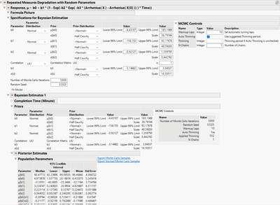

Hi @UrsulaOrsolya,
I do not believe you would be able to get what you are looking for directly in the fit curve platform. What I would suggest is the following:
1. Save the parametric prediction formula using the model that @Ben_BarrIngh fit in his attached JMP file.
2. Next, use the nonlinear platform with your raw data and parametric prediction formula.
3. Lock your a parameter to 80, which is parameterized as your initial value in the First Order with Limits model we fit. Then hit go. Click the confidence interval button so the algorithm gives you CI for your b and c parameter. Then open up the prediction profiler.
Then if you want, you can save this prediction formula and its associated confidence/prediction intervals.
I should add this is a fairly brute force way to acquire this prediction in JMP and what I think would be a more statistically sound way to get what you want is to use R or Python to fit a bayesian nonlinear model which would allow you to 1. account for any correlation between your starting value and the degradation rate and 2. Use your batch-to-batch variability and MCMC sampling to make predictions for future unobserved batches at any given initial value.

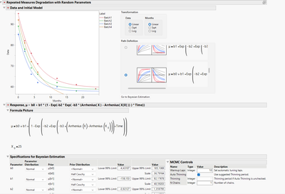

Hi @UrsulaOrsolya,
Could you provide the equation/formula you were using for this that were failing?

Thank you for the response! This is where I am currently at. I created a separate coloumn in tha data for temperature (25 C for all data points). But I am unsure how to use this to predict for the hypothetical release value of 80%.

Hi Ursula,
Just to clarify, what is the target ('reference' in JMP) temperature you're aiming for with the Modified Arrhenius? With just a single temperature it becomes difficult to correctly estimate parameters.
When you say you're looking at 80% - is this as a spec limit to cross? Or are you looking for what the value would be at 24 months?

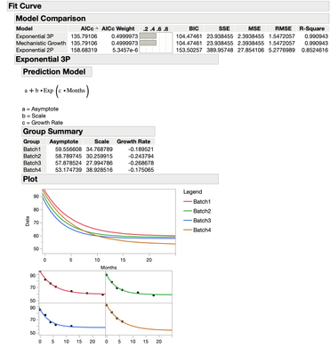

Exponential 3P or Mechanistic Growth models seem to fit this data well:

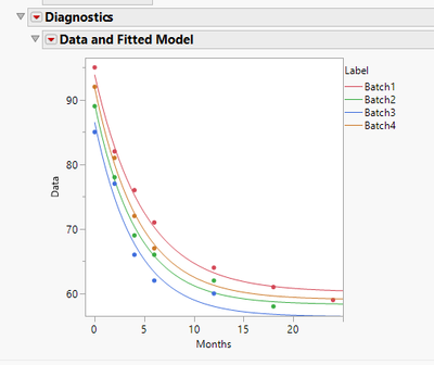

Hi @UrsulaOrsolya, I've attached your data table back with a script saved using Fit Curve - because you're not exploring different temperatures it might be better to fit a first-order rate equation and use the profiler to identify the likely response at X months.

Thank you for your help! This approach does not fully meet our objective, as the curve is fitted to the entire dataset without accounting for the fact that degradation behavior may differ depending on the initial value. It is important to consider that samples with different starting points at time zero may degrade somewhat differently over time. The aim is to know what might happen if we would start a 80% at 0 months.

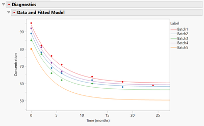

Thank you for the suggestion! My aim would be something like this but with confidence intervals:
So I would like to find a general formula based on the measured data and then use it for the hypothetical sample that starts at 80% at 0 months (batch 5).
I am not sure how to use the Fit Curve platform for this purpuse. Do you have any tips?
