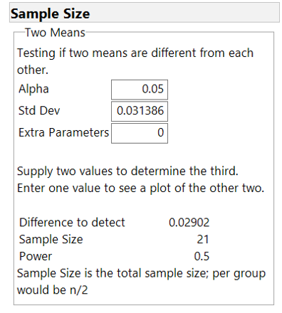

You might want to look at the sample size and power analysis platform (In JMP14: DOE > Design Diagnostics > Sample Size and Power).
This result agrees with the power analysis in your oneway analysis that to have a 50% chance of seeing a significant difference (p<0.05) when the true difference is 0.02902 or greater and with a std dev of 0.031386 you would need 21 samples in total. Just note that the difference to detect is defined differently in the two platforms: difference from overall mean in Oneway and difference between groups in Sample Size and Power.
50% power may not be enough. 80% is often the required power and that would require 39 samples.
This may seem like a lot but you need to consider that your within group std dev is large compared to the size of difference you want to detect.
