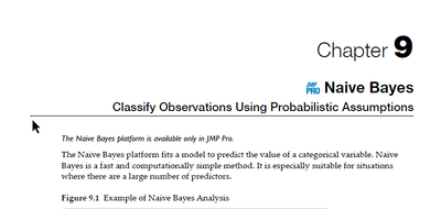

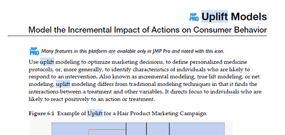

Re: Possible to do Bayesian Regression in JMP?
Which Version do you use? From the Manual Bayes and consumer research are in the Pro version.
