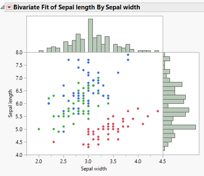

I want to plot histogram with scatter plot for the same data as below.
Can anyone help me please?

You can add histogram borders in the Fit Y by X platform using the red triangle, and you can use the hand tool to adjust the width of the bars.
