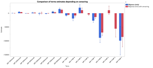

    As an example, I have run the analysis with GenReg on your data with and without detection limits (upper limit set at 1000) property column. The outcomes are different:
    • On the estimates and terms present in the model (models built in the same way in both cases, GenReg with Pruned Forward Regression estimation based on AICc criterion):
      In the model built with censoring, several interactions are added (MP2xMP6, MP3xMP5 and MP4xMP5) compared to the model without censoring
    • On the optimum found: when using the Profiler in both situations (with and without censoring), the optimum found is different (different values for MP2, MP5 and MP6, linked to the interactions missing from the model without censoring):
You can learn more about detection limits and censoring here: Limits of Detection (LoD) - New in JMP Pro 16 - User Community.
