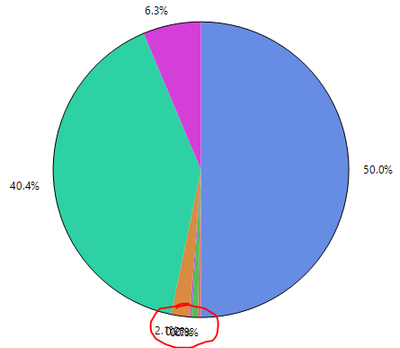

I have a pie chart that will naturally have some smaller percentages.
Does anybody know how I can space out these labels?  I can't seem to do it manually.
This is a chart I will be creating in JSL.
Thank you!

I was able to simply drag the labels to a different position, see screenshot (JMP Pro 16.1 on WIN10).
There you also can see, how this is done in JSL. See the full script below.
