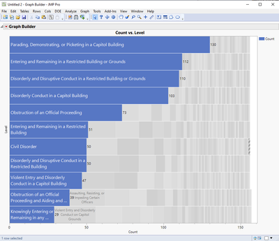

Thanks! I did not know about the Multiple Response data type. Cool thing: Recode works on a Multiple Response Column, treating each response as a value. So, there are 490 values that need to be recoded. I will be busy for a while...
markschahl
Level VI
Re: Parsing phrases separated by ;

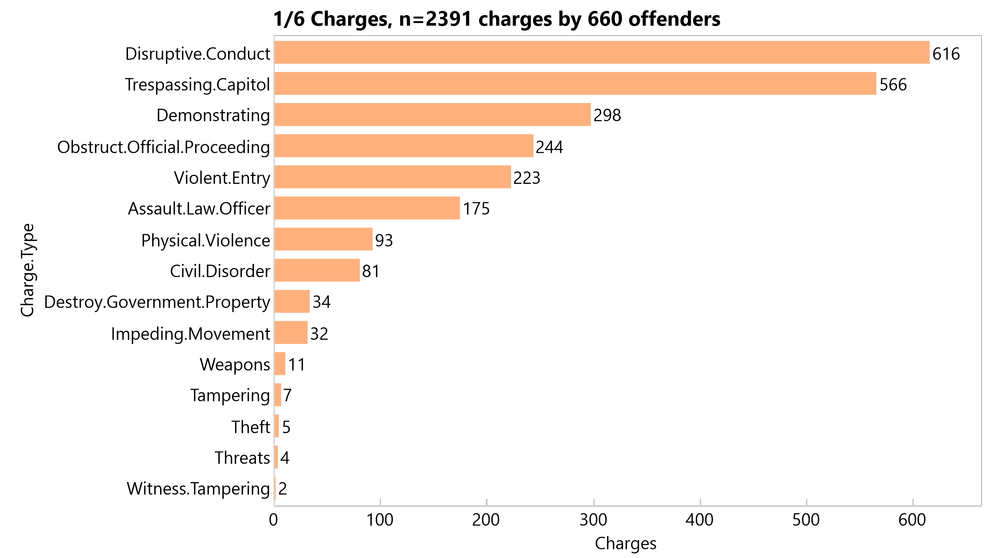

Took a lot of recoding, but here is the summary. I'm not done with this dataset. I want to learn Regex() so I can extract the arrest dates to plot how fast DoJ worked.
