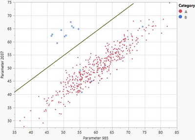

It would be great to get inputs on an approach to automate identification of parameters that can distinguish a bivariate response as shown in the example plot below. The data set has ~20k numerical continuous columns and one character response column. The response column has entries of the letter A or B.
Objective is to identify parameters that can identify as many of category B without identifying any (or very few of) category B.
Visually I identified 2 specific parameters that allow identification of the majority of category B without identifying any of category A. It can distinguish them with a linear line. Partition doesn't work well as category B is within the distribution of category A for each of the two parameters individually.
What would be the best approach in jmp/jsl to automate this identification?
Thank you for your time and help. - C

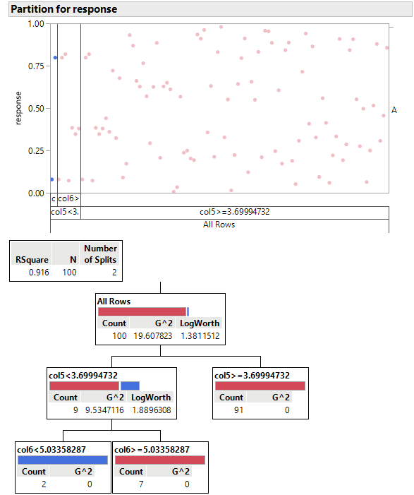

Using @Georg's data table, the JMP Partition result is shown below.  Note since there are only 2 in one group, I set the minimum split size to 2.
Partition selects a slice one input variable cut at a time.
Here is the script for Partition, which can be achieved with the user interface.
Partition(
	Y( :response ),
	X( :col1, :col2, :col3, :col4, :col5, :col6, :col7, :col8, :col9, :col10 ),
	Minimum Size Split( 2 ),
	Informative Missing( 1 ),
	SendToReport(
		Dispatch( {}, "Partition Report", FrameBox, {Frame Size( 480, 56 )} )

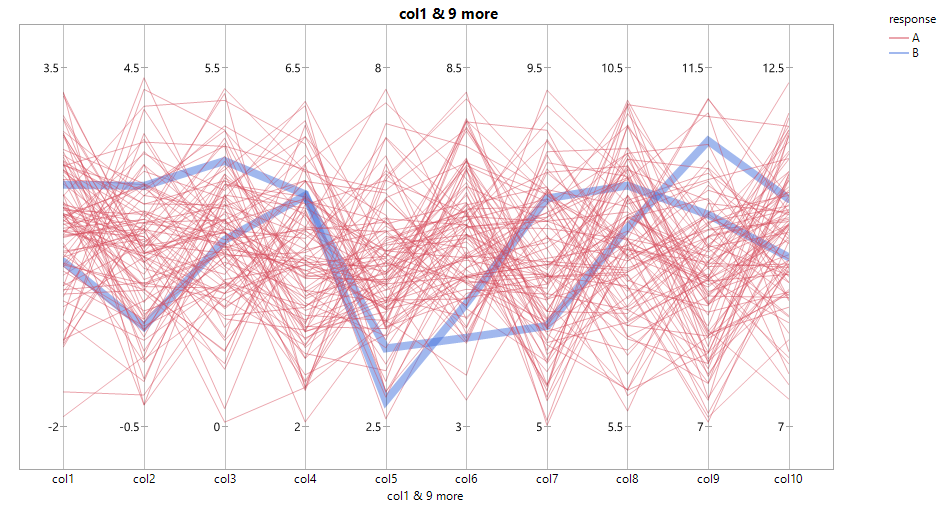

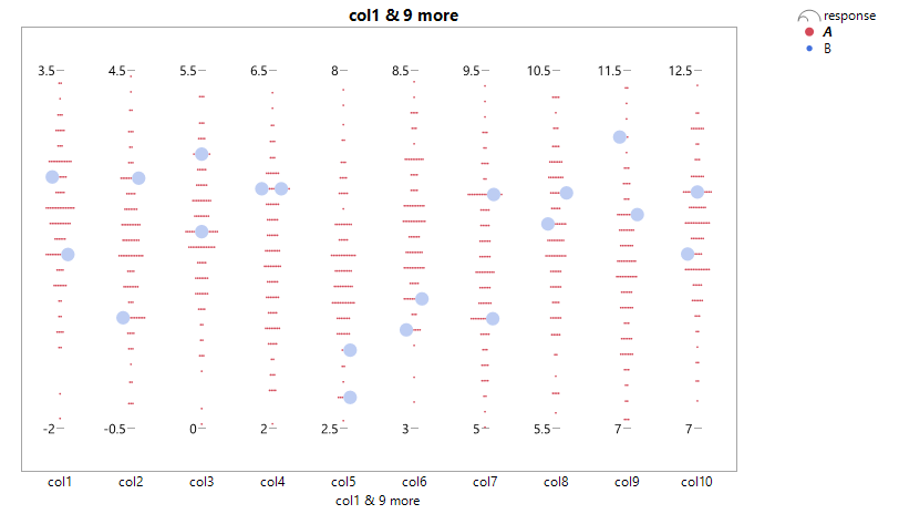

Here is the script of standardized distributions using GraphBuilder
Graph Builder(
	Size( 843, 703 ),
	Variables(
		X( :col1, Combine( "Parallel Independent" ) ),
		X( :col2, Position( 1 ), Combine( "Parallel Independent" ) ),
		X( :col3, Position( 1 ), Combine( "Parallel Independent" ) ),
		X( :col4, Position( 1 ), Combine( "Parallel Independent" ) ),
		X( :col5, Position( 1 ), Combine( "Parallel Independent" ) ),
		X( :col6, Position( 1 ), Combine( "Parallel Independent" ) ),
		X( :col7, Position( 1 ), Combine( "Parallel Independent" ) ),
		X( :col8, Position( 1 ), Combine( "Parallel Independent" ) ),
		X( :col9, Position( 1 ), Combine( "Parallel Independent" ) ),
		X( :col10, Position( 1 ), Combine( "Parallel Independent" ) ),
		Color( :response ),
		Size( :response )
	Elements(
		Points(
			X( 1 ),
			X( 2 ),
			X( 3 ),
			X( 4 ),
			X( 5 ),
			X( 6 ),
			X( 7 ),
			X( 8 ),
			X( 9 ),
			X( 10 ),
			Legend( 17 )
Or make it a parallel plot.
