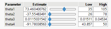

is there some update for constraints in nonlinear fit?
there are min/max settings at the bottom of the report - but when I click on Go the fit result is outside of min-max.

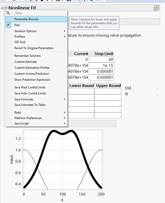

actually, I was trying to fit 2 peaks and tried to limit the fit range for the centers.
Difficult to fit the Peaks when the tails don't match to the fit curve ; )
While playing with the fit, I wondered if I can optimize the fit by restricting the range for the x1/x2 scan.
... and wondered if there is a way in the platform to restrict.

Re: Parameter Constraints in Nonlinear Model Fitting
Hi @hogi ,
You need to go in through the parameter bounds (Red triangle) and set those up first before hitting go to stop it exceeding points. Although the Low/High should update in the plot table below, maybe worth reporting to [email protected].
Does that resolve what you're trying to achieve?

hogi
Level XIII
Ah, wonderful, thanks :)
