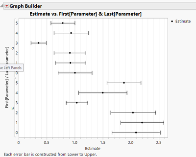

I'm not sure I'm understanding completely what you're looking for, but this sounds a bit like a Reliability problem. With your data table, I used the Fit Life by X platform, assumed a Lognormal distribution, then from the nonparametric overlay plot I could see that White 2 was the only different distribution.
This isn't exactly a pairwise comparison, so I made the Estimates table into a data table and used Graph Builder to show intervals for location and scale, which is more like the pairwise comparison.
Is this what you're looking for?

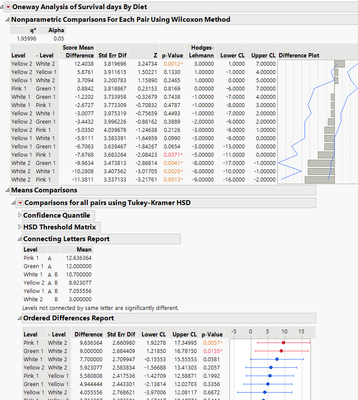

Ah, you can do this in the Fit Y by X platform. To get the Wilcoxon (and other nonparametric) pairwise tests, select the red triangle...Nonparametric...Wilcoxon Each Pair. For more traditional (mean/stdev) pairwise comparisons, select the red triangle...Compare Means...then one of the options (usually student's t or Tukey). I've attached a script to run this to your sample table.
