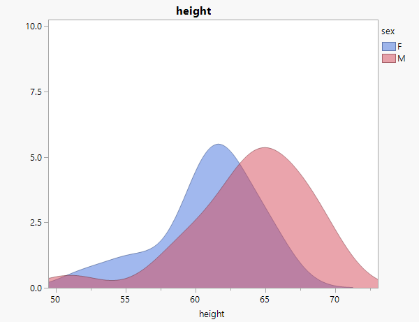

Personally, I am not a fan of overlaid histograms. The overlapping bars hide too much. Fortunately, Graph Builder allows you to switch from bars to the kernel density:
This is clearer to me at least.
I figured out how to get them overlaid, but I am not very happy with the look.
I used the kernel density picture shown above. I then right-clicked the graph and chose Edit > Copy Frame Contents.
Now switch the picture back to the bars.
Right-click the graph and choose Edit > Paste Frame Contents.
< last picture doesn't seem to be displaying so I have attached it>
There are likely some ways to make this prettier, but I have not spent any time looking into that.
