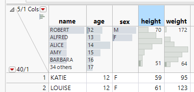

One can close the panels on the left of a data box with the command  close side panels( 1 );
The command can be be sent as a message to the data box after the box is generated.
Is there also an option which can be added to the New Data Box() command such that the data box is already opened without the panels?

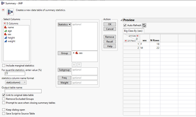

I want to use the data box similar to the new (Jmp17) preview tabs for table commands: a preview which is automaticall changed if the user changes settings.
I still hope to find a solution -  the previews in the table commands don't flicker.

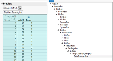

Even if the preview in JMP17 seems to be data table box it doesn't seem to be exactly the same as we have access to
JMP17 preview: You cannot show side panel with the button (as it is missing)
Also the table is locked and right click doesn't do anything (most likely there are other differences also). It seems to be DataBrowserBox (I think New Data Box() also generates one, but still there are differences)
