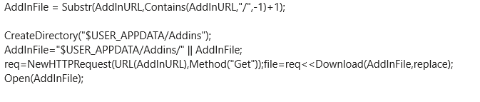

hardner
Level VI
Re: Open microsoft office 365 cloud-based excel from JMP/JSL?
This is not specific to o365 but to opening .jmpaddin from a URL as vs. a local path. At least I see the difference between local paths and other non-office URLs.
Here is a way to refresh an addin that's in a URL-accessible location  that I got from colleagues...using NewHTTPRequest() to get file, put in local spot and then open()
