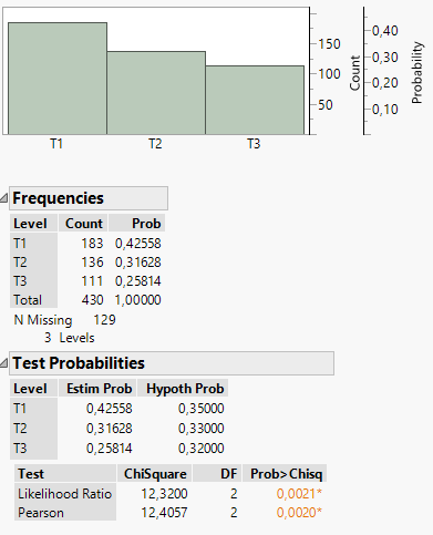

I'm looking at the distribution of individuals participating in different events. Here, I'm looking at "thirds" (i.e., first, second, third part of the year, not sure "Tertial" is the correct word in english), could also be quarters, Q1-Q4.
When doing a distribution plot, I can also test the probability/ do a chi-2 test, and thereafter get the likelihood ratio, and its confidence intervals. However, is there a easy way of calculating the Odds Ratio for this? That is, the odds that you are placed (in this case, born) in T1 instead of T3. I've tried to look around and one can doo Odds ratios under logistic regression models but that seems inappropiate for this case?

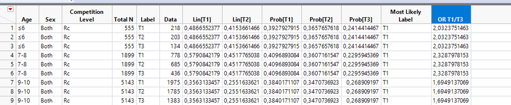

Thanks for you patience!
Hm, I already have the likelihood ratios from previous analysis. However, in this format I could automatically calculate ORs using Formulas, (but what about 95% CI for OR?)
Also, for me these doesn't make sense:
T3 can't have the highest probability, with fewest individuals?

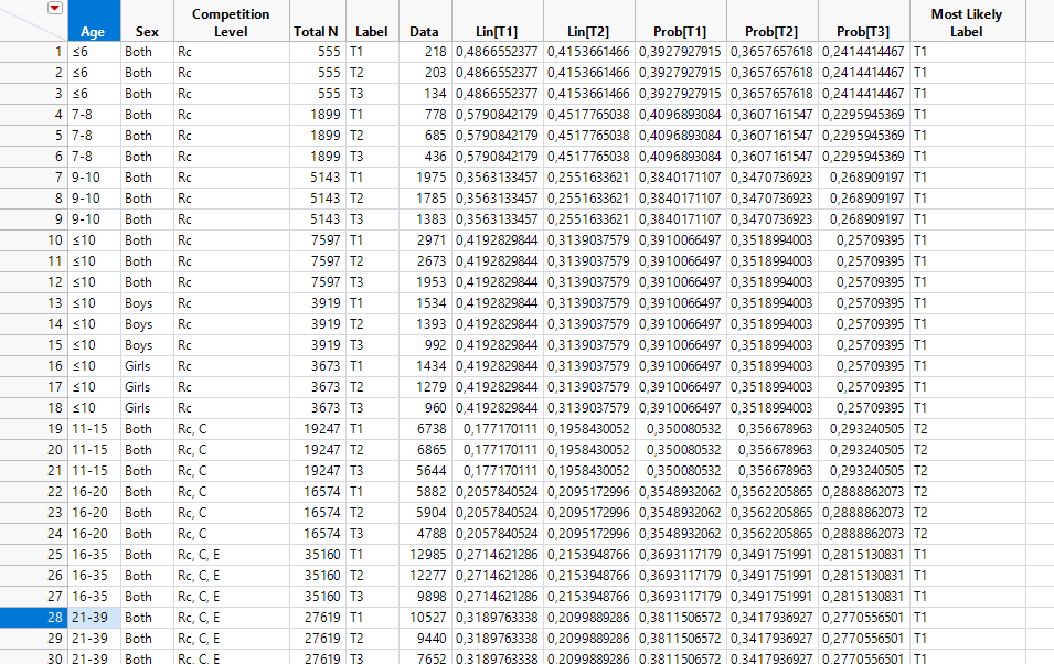

The model is for the marginal probability. Is it true that the group T3 is always smaller? You could use Tables > Summary to get the Sum for T1-T3 overall. Those sums are where the probabilities come from. (You did not enter any covariates so the probabilities are not estimated for each grouping.)

Well, almost always. But in that dataset, as you can see T3 has the fewest but highest probability.
Now, with Age as Covariate (As a model effect?) it says: Failed: Cannot Decrease Objective Function, but can proceed and now it makes some sense:

Then, using the formula, I get the OR, which seems correct. Then I just need to come up with the formula for calculating 95% CI using this set... Anyone?
