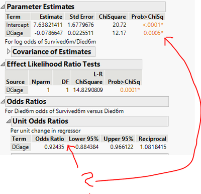

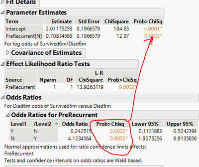

When performing an odds ration analysis on a nominal variable I get a p-value which is identical to the p-value of the parameter estimate (see pic below).
When performing the same on a continues variable there is no p-value (see pic below).
Could I use the p-value of the parameter estimate as the p-value of the odds ratio?
If not how could I obtain the p-value in JMP?
