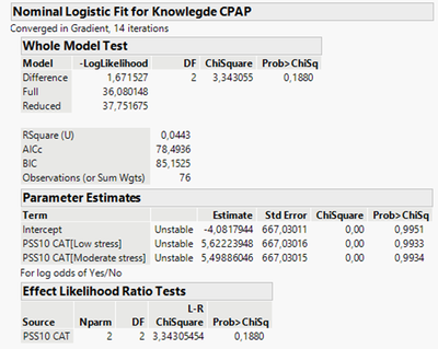

Regarding the "instable results", I added an output.
Thanks in advance!

Did you know with nominal logistic regression, you are modeling the log ( odds ratio ) = the linear model? The odds ratio is the ratio of the odds of Knowledge CPAP = yesversus the odds of Knowledge CPAP = no. The odds are, in turn, the ratio of the probabilities for the two outcomes. So the coefficients might not be directly interpretable. You can save the prediction formulas and see a set of new data columns with formulas. The first formulas are the linear predictor. The second formulas are the inverse log ( odds ratio ), or probabilities. The Prediction Profiler on the probabilities might be the easiest way to interpret the model.
Is there a reason you did not use all the predictors simultaneously in your model?
Can you show a plot of the distribution of Knowledge CPAP and PSS10 CAT? It might be helpful to start Fit Y by X with Knowledge CPAP in the Y role and PSS10 CAT in the X role. You should launch the Contingency platform this way. Let's see what the cell counts are in the contingency table.
