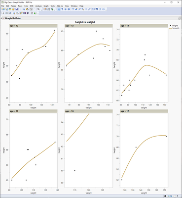

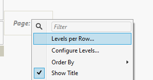

One thing it could mean is levels per row when using Page
With 3 levels per row
