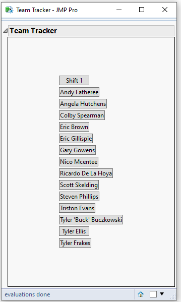

I am attempting to create a tracker for technician training, hour logs, etc. I am using a for loop to gather the information and turn it into data tables to be graphed. I then, in the same for loop, create a button and append it to the main window for each technician. When the button is pressed, the technician's window comes up as a journal with 2 outline boxes.

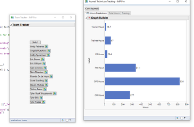

Now, here's the issue:
When the button is pressed it opens a journal with the 2 outline boxes and the graph inside the correct outline box, however, the graph is only representative of the last name in the list. All of the graphs show the same data. I have tried countless things to try and fix this issue, but I am not experienced enough to see what I am missing.

8 REPLIES 8
Byron_JMP
Staff
Re: Need help with for loop and assigning journals via button boxes
would it work to make a graph with a local data filter?
that way you get all the dynamic linking between the graph and the data.
JMP Systems Engineer, Health and Life Sciences (Pharma)
KyleGorsage
Level II
I'm not sure what that would look like.
As I said, I started learning this last Monday, and am attempting to learn on the go here.
Byron_JMP
Staff
if all the data from all the techs were in one table, then you could make the graph builder figure you have and add a local data filter to change the graph contents for each level of tech.
Journals are kind of a pain to work with like this. Is there some specific reason you choose to this display method?
KyleGorsage
Level II
The main reason I chose a journal was to display all of the graphs in one clean presentation. The goal with this project is to have multiple graphs of training progress, hours worked, certification progress, etc, and from what I was reading Journals seemed like the best choice. If there is an easier way to go, by all means, I'll do it another way!
Can I add a filter function to the button box so that the graph is shown when you press the specific techs button? And I also changed the layout a little bit so they are now in tab boxes for easier sorting of information. My thought was that I could append each graph to the tab page box it belongs to
txnelson
I believe the issue is that your Graph Builder platform is always running against the last  table created for the last technician.
From what I can tell, there is a separate data table for each technician, and you need the Graph Builder to point to that specific data table.
If you change out with the following code, I believe you will get what you want.  As a note, I could not test this because no real data was posted
tb = Button Box( technician_name,
	nw = New Window( "Technician Tracking",
		<<journal,
		Button Box( "Close Journal", Close All( Journals, No Save ) ),
		ob = Outline Box( "YTD Hours Breakdown",
			Eval(
				Substitute(
						Expr(
							gbb = Data Table( __techName__ ) <<
							Graph Builder(
								Variables( X( :Hours ), Y( :Label ) ),
								show control panel( 0 ),
								show legend( 0 ),
								show title( 0 ),
								Elements(
									Bar(
										X,
										Y,
										Summary Statistic( "Sum" ),
										Label( "Label by Value" )
					Expr( __techName__ ), technician_name || "_Tabulated Transposed"
		Outline Box( "Total Hours" )
Jim

KyleGorsage
Level II
Any other ideas on how I might solve this issue? You are correct about it only pulling from the last table. In your script, it calls upon the table of the last tech as well. Is there a way you can make it check the name of the button against the name of the table it is pulling up?
Thank you for your help
txnelson
I have reworked my code, and it appears to do the substitution correctly.  I am assuming that the Graph Builder should be running on data table Jim_Tabulated Transposed if the Jim button had been pressed, and if the Steve button had been pressed, it would run against Steve_Tabulated Transposed data table.

				Expr(
							<<journal,
								gbb = Data Table( __techName__ ) << Graph Builder(
									show legend( 0 ),
									show title( 0 ),
									Elements( Bar( X, Y, Summary Statistic( "Sum" ), Label( "Label by Value" ) ) )
	//Appending the created button to the main page, closing/ hiding tables
	sh1 << append( tb );
	Close( Data Table( technician_name || "_Full_Data" ), No save );
	Close( Data Table( technician_name || "Tabulated" ), No save );
	Data Table( technician_name || "_Tabulated Transposed" ) << show window( 0 );
//Closing tables selectively
Close( Data Table( "Technicians" ), No save );
Close( Data Table( "Use for Graphs" ), No save );
Close( Data Table( "Use for Tech Tabulating" ), No save );
Close( Data Table( "Total Hours for all WO's" ), No save );
Close( Data Table( "Year to Date OPS Hours" ), nosave );
Close( Data Table( "Year to Date PM Hours" ), nosave );
Close( Data Table( "Year to Date CM Hours" ), nosave );
Close( Data Table( "Year to Date PR Hours" ), nosave );
Close( Data Table( "Year to Date Trainee Hours" ), nosave );
Close( Data Table( "Year to Date Trainer Hours" ), nosave );
