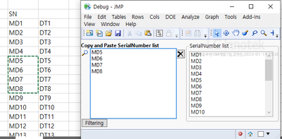

Need help to find out the difference of two variables listed here

Copy and Paste Excel values (Certain SerialNumber) into text edit box  and sort the Panel box (inserted SerialNumber)

By the way, when I input below values in text edit box, it seems the extracted string has delimiter " ", but it cannot be splitted as I thought.
MD5
MD6
MD7
MD8
I added simple script to check if it is splitted well, as you can see below figure, "str" can be splitted, however, "tmp" cannot.
When I put the values to excel and compare it with Exact function, both value is just same, but seems like JSL classified two variable as different one.

Could you find out what is the difference and let me know the solution?

Try using "\!N" as separator for tmp instead of " ".
Most likely the separator is some sort of row change and not " " when you copy-paste values from Excel. I'm not sure where your variable image is from (JSL Debugger?) but maybe it cannot show row changes properly?
Edit: Also depending on your application, sometimes you might be better off replacing all white spaces (or just different kinds of row changes) with some character (I usually use ¤) using Regex and then using Words to split on that character. I usually do this, because the copy-pasted values might have all kinds of weird whitespace characters and just splitting on \!N won't be enough.

Thanks for kind explanation and good way for the debugging!
It's first time I learned Regular Expression (Regex) in JSL.
Many thanks!
FYI, I captured debugger tool for the snapshot as you mentioned.
