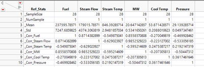

I'm not getting any errors when I follow the instructions in the link you provided. Can you confirm that the table you're saving to disk (main step 2 from your link) then loading (step 3.5) looks the same as the example shown in step 2.1 (copy of image below)?
Re: Multivariate Control Chart Get Targets Error
I had no problem running the data as a whole. The error occurs when I try to run step 1 and 3 with the same dataset using "hide & exclude" on different parts of the data during the two steps. I found a workaround by splitting the data into two separate files like in the examples given.
