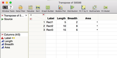

In your example, take the data table you describe:
and recognize that you've got your entities (Rectangles) in the columns and your measures (Length, Breadth, Area) in the rows.
If that's the way the data was handed to you, no problem. Just reshape it using Tables->Transpose and you end up with this.
Notice now you have one row for each Rectangle and one column for each measure. Now you can use the Formula Editor to multiply the Length and Breadth to compute the Area.

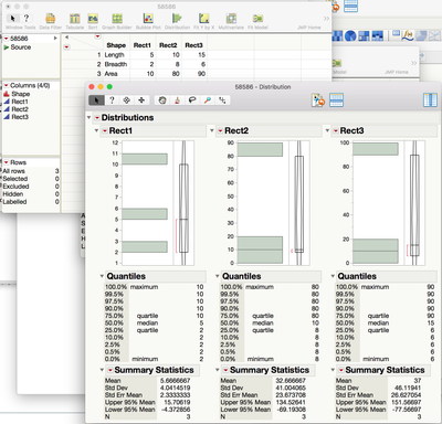

I hope that helps explain a bit about why it wasn't obvious how to multiply rows. Math across rows doesn't make sense for a JMP data table. After all, what would Distribution mean on data in that format?
