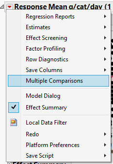

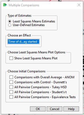

Hi @NishaKumar : OK. Yes there are several options within the Fit Model platform. Which method you choose, as you well know, depends on goals/priorities/etc. It is on the red triangle pull-down menu. See pics below.

I don't think those options are available for a nominal response variable - the study being referred to results in odds ratios, so I don't think those options apply. (I might be wrong)

How did you get to the response mean tab from fit model output?
What I did was go to fit model under analyze, ran it and in the output selected wald test and odds ratio. On that screen is also the FDR logsworth, but I am curious to understand how you got to the screens you provided in the screen shot please.
