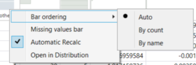

Sometimes, a new version has a bug which was not there in an old version. Some features get removed accidentally.
like Bar ordering
or Clear row states: Add Clear Row States back to row right-click menu
Then it's good to have the old version as a backup.

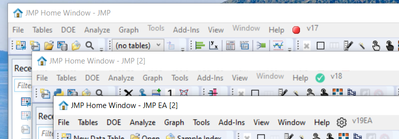

To distinguish the different versions, you can use the AddIn: Identify different JMP versions
