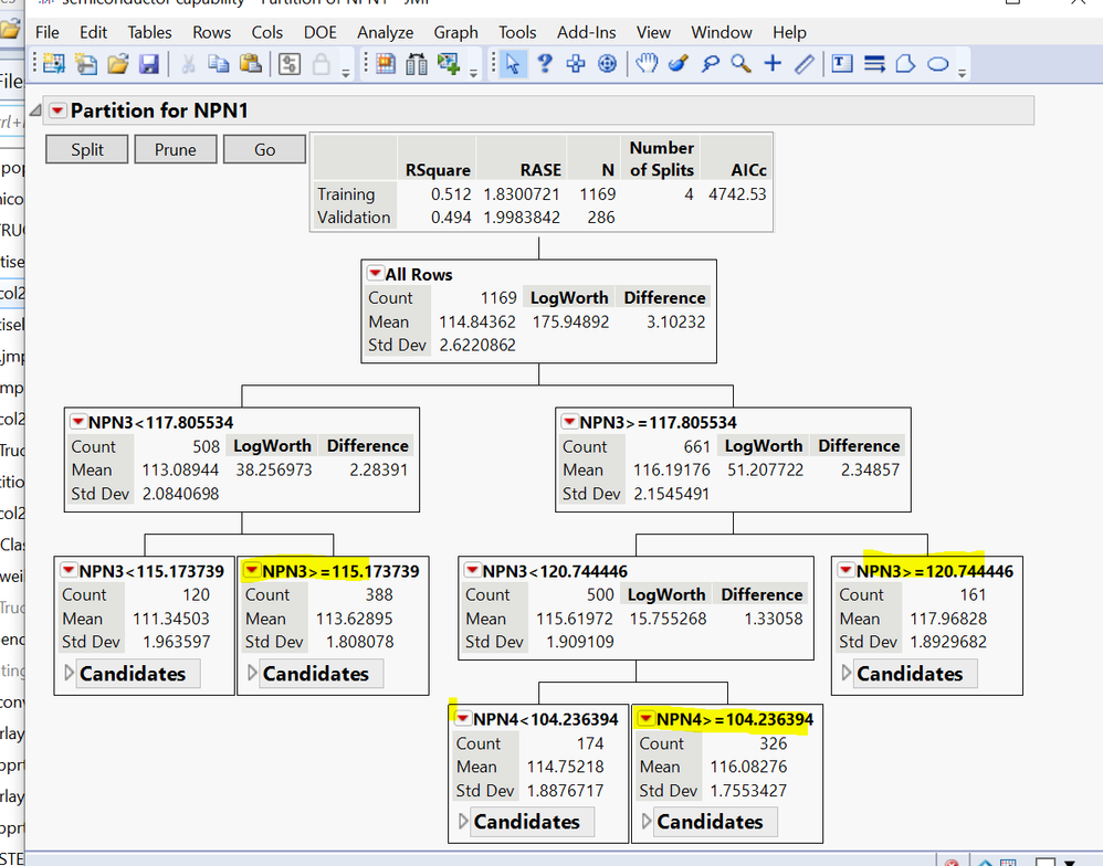

I want to select multiple segments when the partition model is shown. The selected segments will go into the badpopulation jmp file and the rest will go to the good population jmp file. But I don't know how to code it for multiple selection of the segments.
My code is as follows where it can make the separation into two categories:

I want to add for multiple segments,suppose the highlighted ones and get them into one jmp file
(badpopulation) and rest data into other jmp file(goodpopulation) can anyone help me regarding this coding? snapseg.PNG

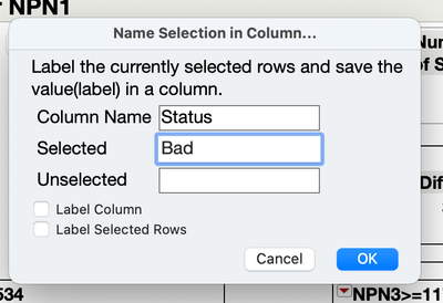

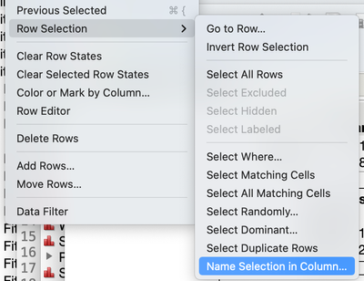

Next Name the Selection in Column from the Rows menu tab
Enter a title for your new column and a label for your "bad" rows.
Don't enter a value for the unselected rows. Just leave it blank
Repeat this step for each "Bad" Leaf

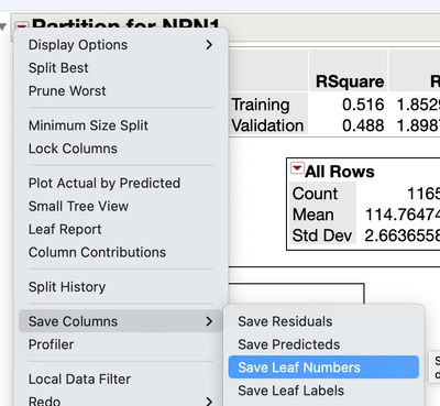

After you build your tree. Use the RTM to Save the Leaf Numbers

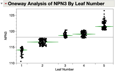

Then use Fit YbyX to do an ANOVA using Leaf Number as the X and your response at the Y, and pick the "Bad" leaves off the tree.
