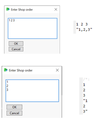

Re: Multiple input for SQL data pull using JMP script.
Thanks Jarmo,
Text edit box function worked great.
When I enter multiple order number in a same raw and replace space with "," it worked fine.
I want to make it robust. How can I handle the input when it is entered vertically.(I need this when I copy list from excel.)
Names Default To Here(1);
nw = New Window("Enter Shop order",
	<<Modal,
	<<Return Result,
	V List Box(
		Text Box(" "),
		variablebox = Text Edit Box("", << Set N Lines(5), << Set Width(200)),
		Spacer Box(Size(0, 10)),
		Button Box("OK"),
		Button Box("Cancel")
Write( nw["variablebox"] );
unique = nw["variablebox"];
sql_in = Substitute( unique, " ", "," );
jthi
Best method I have come up with has generally been Regex but the pattern depends on your use case. In this case you could maybe just use Collapse Whitespace + Words
	<<Modal,
	<<Return Result,
	V List Box(
		Text Box(" "),
		variablebox = Text Edit Box("", <<Set N Lines(5), <<Set Width(200)),
		Button Box("OK"),
unique = Collapse Whitespace(nw["variablebox"]);
sql_in = Associative Array(Words(unique, ", ")) << get keys;
sql_in = Concat Items(sql_in, ", ");
You could also clean the input in such a way that user will see it when they commit the change
