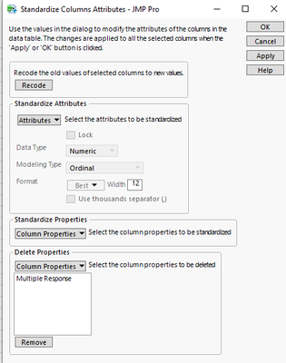

You can also remove these by using Standardize Column Attributes (at least this worked for me):
1. Select all weirdly behaving columns
2. Open Standardize Column Attributes and delete Multiple Response column property

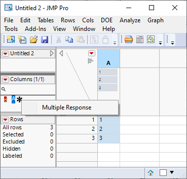

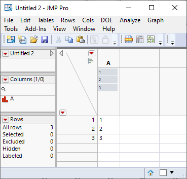

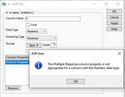

It might also be a good idea to contact JMP Support about this. This can be easily replicated (Using JMP16.2 Pro on Windows):
1. Create table with Character column with numeric values
2. Set Multiple Response Column property
3. Change data type to numeric and modeling type to nominal
4. Now you have Numeric column with Multiple Response set
5. Go back to the column menu and change Data type back to Character
6. Close column menu and reopen it. Multiple Response will be visible again
-Jarmo

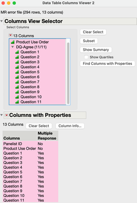

Re: Multiple Response error
Hi Mark,
Thank you!  Column Viewer enabled me to find the columns causing the issue, however, none of them show "Multiple Response" in their column properties.
I've deleted most of the columns in the file so it is easy to see the ones causing the issue (Question 1-11).  I've tried using "Standardize Attributes" to change the "modeling type" a couple of times just to see if that would reset something...  but, they still show as MR columns in the Column Viewer.  Any thoughts on how I might correct this (i.e. clear "MR" from these columns)?  I've attached the file below.
Hi there,
Thank you - that was my issue!  I had Multiple Response column properties, but could not see them since the column was set to numeric.  I used your suggestion of Standardize Attributes to remove the Multiple Response column property.
