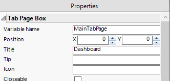

The red-triangle menu for the top-level TabPage in a Dashboard comes from a script embedded in the Dashboard.  The default Dashboard templates create a variable `MainTabPage` to refer to this box (objects visible if you toggle Show Properties):
The template script includes this line:
Try( MainTabPage << Set Scriptable Object( thisApplication ) );
The script is only visible if you toggle off Dashboard Mode.  Is there any chance that you either changed the name of the tab page or modified the script?
Edit: changing the title of the Tab Page is fine - it's just the variable name that the script depends on:

I recreated the Dashboard without the red triangle from the one that had the red triangle and then copied the script.  That worked.
Obviously one dashboard had the required line, while the other didn't.
